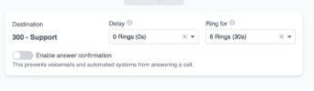

There is a setting to keep the voicemail from answering on the other side in ring groups and follow me. I don't remember what it's called in FusionPBX. In FS PBX, we renamed it to make its purpose easier to understand. In our system, it's called Enable Answer Confirmation
thanks for that, not sure if this is the same setting, but I tested it as the below and it works, so appreciate you pointing me in the right direction!
