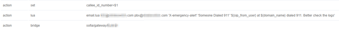

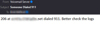

The notes above assume you have working SMTP settings in fusionpbx. If voicemail to email etc are working, all you have to do is add the action to your 911 dial plan before the bridge statement.
