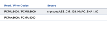

When I call from this extension, I have encryption and fusionpbx does the bridge to the unencrypted extension. (cool)
