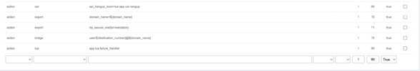

Think I managed to figure it out.
I had to change my DialPlan to force SRTP.
Here's what I changed.
Under DialPlan -> DialPlan Manager
Edited local_extension (Down near the bottom. Entry 890)
At the bottom of the page, add the following:
Tag = Action
Type=export
Data=rtp_secure_media=mandatory
Order=71
Should look like this:
Hopefully that helps someone else out.
