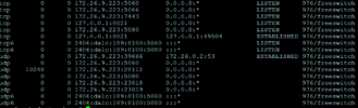

What does this command show?
If netstat is not installed, use: apt install net-tools
netstat -antup | grep freeswitch
Reactions: vuthy09
So freeswitch is clearly listening there on UDP on the internal profile:
udp 0 0 172.26.9.223:5060
