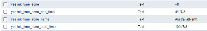

mcs3ss2 Active Member Sep 8, 2020 323 37 28 AU Apr 22, 2023 #2 Here is what I use for Dalight Saving Time in Australia for one of my client in Western Australia These settings can be used on dafault settings or per domain settings

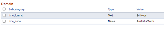

R reap.virtue Member Mar 2, 2023 109 2 18 24 Apr 22, 2023 #3 I have done that hab a look at the screenshot below
mcs3ss2 Active Member Sep 8, 2020 323 37 28 AU Apr 22, 2023 #4 see if this helps you out https://techtips.com.au/2022/05/23/incorrect-time-fusionpbx/
