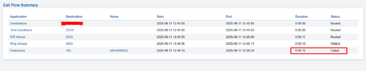

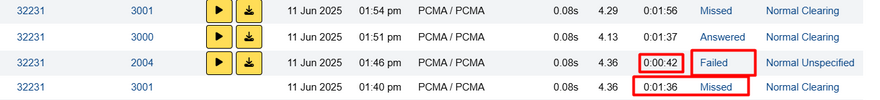

    Hi, We are experiencing issues with the CDRs after updating FusionPBX to the latest version (5.3.8). As shown in the attached...
