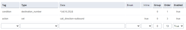

What I did for a certain domain that needed the "outbound" variable set earlier is to add a custom dial plan around order 15 but anything before the call-limit dial plan should work. I check for 10+ digits since all outbound calls for this customer require the area code. if the condition matches, it sets the direction variable. The key to making sure the variable is set when you need it is to set "inline" to true.
