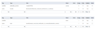

the build in option for redial code seems to work only to last "local" call and not an outbound call
i have made a call first to extension 3001 and then made another call to external number.
once done and calling *870 call are made to extension 3001 and not to last external number.
Dialplan Detail TagDialplan Detail TypeDialplan Detail DataDialplan Detail BreakDialplan Detail InlineDialplan Detail GroupDialplan Detail Order
conditiondestination_number^(redial|*870)$on-true05
actiontransfer${hash(select/${domain_name}-last_dial/${caller_id_number})}010
conditionnever120
actionhashinsert/${domain_name}-last_dial/${caller_id_number}/${destination_number}125
Can you guys check it in your system and let me know if you are facing same issue or not?...

The issue is not with ip phone redial option.
It's facing when using Fusionpbx redial code *870, system not dialing to last external dialed number...

It's exactly the same, is your outbound routes triggering before the redial entry? I have all my outbound routes at order 900-999 to go through the entire internal dialplan before sending it out the trunk.
