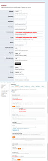

no username or password, use the "Register False". See attached graphic.
Also for Chime, your "Outbound Caller ID Number" has to be +15555551212 if you don't have the +1, it wont go out.
