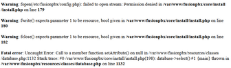

So I've tried going down the route migrating to a new server with Debian 11 and following the instructions to install FusionPBX clean and the restore script from the member centre. However after it completes (second attempt without error) when accessing via a browser I get this:
followed by
I used the admin password generated by the install in the first picture, and the database password from the old server in the second picture, but then i get this:
Any ideas where i might be going wrong?

- If you use the browser web install then you need to have the /etc/fusionpbx/ writable to www-data until after the update.
chown -R www-data:www-data /etc/fusionpbx
- Then set it back to when you are done
chown -R root:root /etc/fusionpbx
Other option is to run it from command line under root user like this.
cd /var/www/fusionpbx/ && php /var/www/fusionpbx/core/upgrade/upgrade.php

Mark, thank you for your response, to be honest though it didn't really help.
What I did do though, was do another clean install, however before attempting a restore I ensured the original server was fully up to date, and whether it was that, or maybe I read and understood the instructions better I don't know, but this time it went a lot smoother and it all appears to be ok now.
