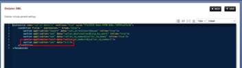

The issue I'm reporting is that if you try to delete an entry from a dialplan, even though the line is removed from the interface after you click "Save", it remains in the XML until you click "Save" again. Screenshots below to reproduce:
Go into any diaplan, such as an inbound route and add an entry, then delete it by checking the "Delete" checkbox and clicking "Save":
The line is removed:
However if you click the "XML" button, you can see the entry is still present:

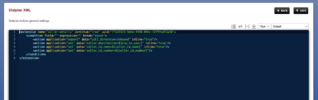

If you go back to the dialplan interface and do nothing other than click "Save", then click "XML" again, you will see the entry has been successfully removed:
Note that while it is in this state, that is it is gone from the interface, but present in the XML, it is still in effect during calls.
Thanks,
Iain
