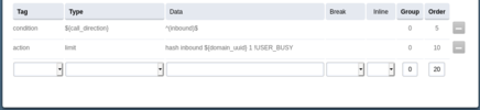

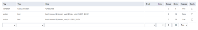

In the Dialplan Manager, have a look at call-limit, by default it is not enabled, you should find it at order 25.
There may be a better way of doing this but one trick I have done in the past with this is to change the condition so it only logs (limits) inbound and instead of using the max_calls variable, I use a literal 1. So it looks a bit like this:
Then I add another dialplan entry to increment the same hash when a chosen extension (in this case 202) makes an outbound call. This time I allow 2 calls so the extension still has the facility to do an attended transfer:
Hopefully this will give you some ideas to play with...

I need to tune a bit further, but indeed this gives me some tools.
I think I need to read up and decode how this limit-data section actually works, but already I am able to at least hard code to 1 or 2 with a nice user busy rather then a cannot reach.
