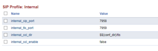

hi, I am new to fusionpbx/freeswitch, very appreciated if any clue is provided.
striaght to the point, the scenarios is pretty simple, I try to change sip port from 5060 to other random port, purpose to avoid anoymous registering attempting as my server is directly exposed on the internet. I have successfully change the port numbers on the vars.xml and sip profile from Fusionpbx GUI. see screen snap shot bottom below;
however, the call is becoming no sound/video at all; although registering account is successful as usual. any comment is very appreciated!

thanks adrian for quick response. I am not using TLS; and I agree with your point about sip registration success means sip communicatting is working well. while I assume I don't need to set up rtp port intentionly as the code should work as usual no matter we set sip port to which port value. but the strange is once we set the sip port back to 5060, all rtp stream is flowing good( can see/hear video/audio ). I guess there is something behind I don't realize, I will need to dig deeper to catch packets from pc sip software phone. I will report back here.
