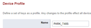

I know provisioning is working ( or part of it) becaluse the devide profile is sent to the phone and BLF buttons get their values
When I press Provision (within device settings or from registration screen) the phone indicator light (red notification light) starts flashing.
After Resetting
Device profile was pushed to the phone but server host address was not. and none of the other variables./settings.
