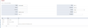

So I changed the default call-forward-all dialplan as per below. (I've tried both redirect and deflect)
Neither seems to work, this is the log for the direct:
with deflect it doesnt seem to do anything
Was looking for any type of help. Cant seem to find anything on any forums.

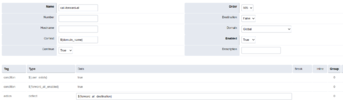

I also have worked out that I definitely have to use deflect.
I've tried doing pcaps it doesn't send anything when it hits the deflect statement, it also doesn't put anything on the log besides deflect.
Does anyone know if I am using the right format for deflect and why it wouldn't output anything on the log or come up in the pcap?
currently doing it like this:
But this also doesnt work:
