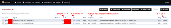

I set up Kamailio to act as a proxy server with load balancing for FusionPBX instances. It works fine, but I have an issue. Now in the Status -> Registrations, I see the external IP of the extension, Kamailio local IP, FusionPBX hostname (see the screenshot).
Without Kamailio, I can see there: extension's local IP-address and extension's external IP-address - that's what I need, to know extension's local IP-address and extension's external IP-address.
I checked the database and see there the information from the web-page (see screenshot).
