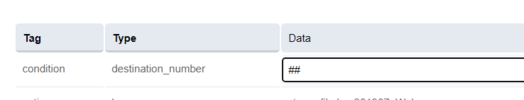

Hi
I assume a few of the IVR options wind up at the same extension
You can either write the IVR as a custom dialplan but then you dont get the nice easy GUI editing of the IVR
or
you can create a few custom dialplans like the attached image.
note that destination is set to true, so you can choose that dialplan as a destination from the dropdown when setting up your IVR
Nic

Interesting and simple, I gave this a test, but for it to show in the IVR destination dropdown, you need a number in the box under name, else it does not show, I tested this with a random number (567) assuming it would transfer to the action transfer 505 XML client.domain.com so it goes to ext 505 but no dice, the log just says ext 567 does not exist.
Add the number in the Number field
and then add this as the first line (replace ## with the number you chose)

That did it, works perfectly in first testing, very elegant solution @neeek thank you
