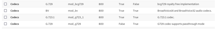

Thank you so much, it dials out but rings once and then stops. Looking at the logs I think I know why, however, not sure how to rectify it.
2024-02-08 16:09:27.959310 95.87% [ERR] mod_g729.c:145 This codec is only usable in passthrough mode!
2024-02-08 16:09:27.959310 95.87% [ERR] switch_core_media.c:16054 Codec G.729 decoder error!
Not sure how to get it on passthrough.
When I dial in, I get the logs and I assume that either its IP related or regex because the number being handed starts with 27, but I don't see where to put regex for inbound. Code below

@simonjw You can download the royalty free mod_bcg729 form here:
wget https://raw.githubusercontent.com/djangopbx/djangopbx-install.sh/master/binaries/mod_bcg729.so
Copy this file to /lib/freeswitch/mods/
Go to Status->Switch Modules and stop the pass thorough G729
Then in Status->switch modules set mod_bcg729 to enabled. and mod_729 to disabled:
Then go back to Status->Switch modules and start bcg729
Reactions: NerdUno and simonjw
Thank you so much, the outbound is working now with no issues. I can even see OPUS being used as I set that up as well.
One thing I did notice there is I had to go into admin -> switch -> modules in order to disable and enable the codecs.
Inbound is no longer throwing an error, however, it is still not working and I believe it to be the rejected by acl "domains" or am I incorrect? Not sure how to correct that as I have tried changing the context.
