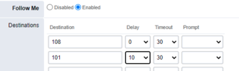

Another possibility that is more automatic is to use the follow me option. It works just like a ring group. Then after say, a two- or three-ring delay, start ringing 101.
Note that follow-me is somewhat counter-intuitive--for example, if you set this for ext 108, then if you do not include 108 in the destination list, it will not ring 108 at all. So something like this would start ringing 101 after two rings:
