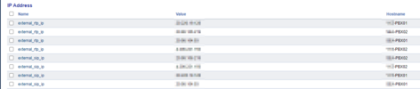

I made a cluster in Azure with 4 nodes using the latest logical master-master replication successfully.
However, in Azure, i need to set the external RTP and SIP IP address in the variables, but it looks like that information is replicated, so one IP is applied to all servers. Is there another way around this?
You need to exclude v_sip_profile_settings table to not be sync in the cluster. I have done this solution using asynchronization clustering methods between two server as active/active (Not membership solution of the FusionPBX). because it will not be unavailable after discontinuing subscription of the membership.

You do not need to exclude tables from the replication, see the following post, you can include local files that are local to the server to set the local ips:
