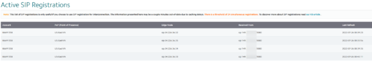

Also worth noting - I am seeing 4 registrations on the Flowroute interconnection page. This appears to NOT be normal, but this is all a learning experience for me!

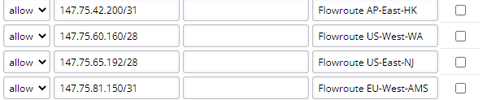

First step is remove the domain names from your ACL page. It should only have the CIDR for each of the flowroute servers you expect to receive calls from. The "domain" field is for a different feature and not used for most instances.
The screenshot below is probably outdated server list but is what it should look like
Thanks, I've done that and still not receiving calls. It seems like it isn't a flowroute thing as much as my server config at this point. I added BulkVS and same thing, able to call out but not receive any inbound calls.

The multi POP registrations are normal.

I seem to have figured it out, it was a problem with the ACLs, and I didn't have the 1 in the country code field. After fixing both, it is working with inbound.
I had the ACL for each provider in their own setting, not listed in the domains ACL.
