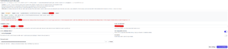

@pbxgeek i'm trying to push tls certs but im getting error when it's trying to create challenge for my failover domain
on public dns
pbx.domain.com points to active (pbxa) node IP address, IP address switches to secondary when primary's down and what phones connect to
pbxa.domain.com = primary node IP address
pbxb.domain.com = secondary node IP address
when i remove pbx.domain.com certs get issues and pushed
with pbx.domain.com i get
Last error: Pre-flight check failed: http://pbx.domain.com/.well-known/acme-challenge/V29R14jFKPVxR9Evt5zug7qLvWUz7D7wQeRXjfL5u54 returned HTTP 200 with unexpected content. Confirm the port-80 server block serves /.well-known/acme-challenge/ directly from the configured webroot and does not redirect that path to HTTPS.
i can get to active node pbxa.domain.com via http://pbx.domain.com which point to pbxa IP address

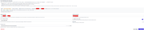

fails with pbx.domain.com pbxa.domain.com pbxb.domain.com
completes with just pbxa/pbxb
