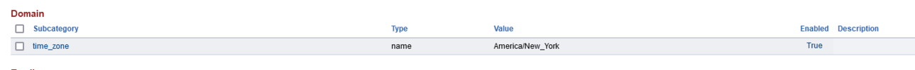

I have a strange issue. The time in my default settings "time_zone" is correct
The time from cli in ssh is correct when I run date or time
But, when I run fs_cli all the log entries are 6 -7 minutes off.
Not sure why this is
