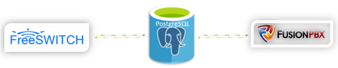

If you break this down into its fundamental component parts it is really quite simple. So here follows a VERY BRIEF explanation.
Correctly configured, FreeSwitch will will work perfectly well on it's own without FusionPBX, however FusionPBX adds extra features and the ability to configure FreeSwitch, so you don't have to.
The PHP code is mostly the web front end and you use this to enter your configuration data which gets stored in a database.
When a call or a registration request comes into Freeswitch, Freeswitch calls an .lua script that is known as an XML handler. This handler reads the database and dynamically generates the XML that Freeswitch needs to handle the registration or call.
And that's about it! Other lua scripts provide facilities like directory look ups or failure handlers that send a call to voicemail or forward the call if any kind of forwarding is enabled.

@Adrian Fretwell, thank you for replying.
It means, Freeswitch fetch its configuration data from PostgreSQL, using Lua Scripts and Fusionpbx create/read/update/delete the information of Freeswitch into PostgreSQL?
In addition, if you can help to understand how Fusionpbx generate xml configuration and how those xml files interact with freeswitch on-fly?
Thank you
1,417
Yes, you have it pretty much correct.
The lua scripts that you will see in /usr/share/freeswitch/scripts/ following a FusionPBX install are part of the FusionPBX distribution not Freeswitch.
To understand how the xml is generated you will need to study the files in /usr/share/freeswitch/scripts/app/xml_handler. How they interact with Freeswitch on-fly is given in the signalwire link in my last post.
