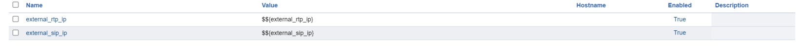

I tried to switch the external_rtp_sip and external_sip-ip to $$(External_rtp_ip) and $$(external_sip_ip) but this did not seem to work. The External IP’s seemed to get mixed up when it failed over.

Currently got the variables set as follows:
I suppose I have understood it incorrectly I was hoping that with it set as tis that it would send it out on the new second IP address once its failed over.
IF i chnage the to Autonat:xxx.xxx.xxx.xxx (second IP) the call connects but as Ivev jjust discovered there is no audio.
I was kind of hoping that getting this setup would auto fail over without having to access and chnage anything I'm obviously wrong and just wishing that this would have worked and almost been a easy was to have High Availability.
