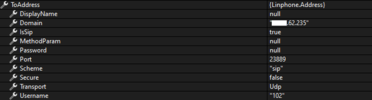

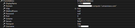

When the call comes in, the FromAddress and ToAddress are as below:
As you can see the FromAddress.DisplayName is the number calling in which is correct, but the ToAddress.DisplayName is null.
Do you know how I can pass a customized parameter to the softphone client? E.g. to_address_display_name=1234
P.S. I haven't traced the code in Linphone to parse the data from the SIP server, but I guess there should be some configuration to fill in these params?
