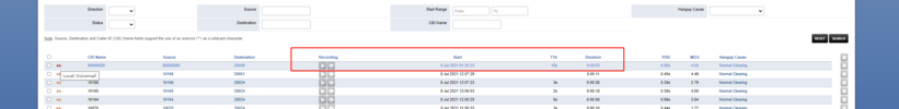

我现在遇到了一个问题。如果是拨打本地号码,会提示相应的彩铃,并得到完整的通话录音,但如果拨打+0的号码(外省),只有接通后的通话录音,彩铃或蜂鸣前面无,如果客户拒绝接听,则不会生成录音文件,也不会返回相应的提示音(如果是本地号码,拨打0/分机之间可以正常获取)。

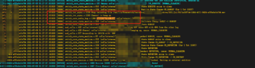

I checked the log and found this hint: (switch_core_media_bug.c:1298 Removing BUG from sofia/internal/)Does it have anything to do with it?f7.png

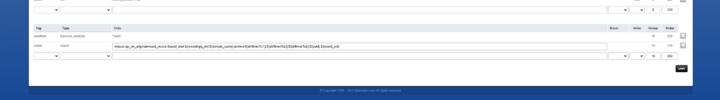

I've just tried this out on my test box. Change the dialplan entry for user_record to:
api_on_pre_answer=uuid_record ${uuid} start ${record_path}/${record_name}
Now it should record the media before the call is answered (pre_answer)
