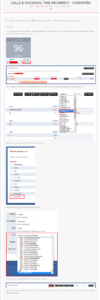

I think i possibly have my server / fusion setup setup wrong in regards to timezones. I have issues with calls being displayed with the wrong times in the call details records screen, but if I click on a call, to look at the details, seems to have the correct date/time.
Also my Time conditions are not activating at the correct time, seeming to not respect the timeszones setup.
I have the server time set
timedatectl set-timezone Australia/Brisbane
I have fusionpbx's Default settings timezone set to Australia/Brisbane
I also have my user account set to timezone Australia/Brisbane
Is there anything i need to restart in freeswitch for changes to take effect, and is this the correct setup for making sure the time conditions will activate at the correct times.
