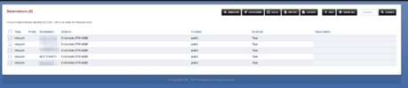

1 RO DID, starting with 40373, setup on a Gateway
This is how the Inbound Routes are setup:

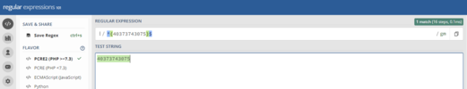

Checking with regex101, the expression passes without any issue:

Unfortunately, the call still fails and I do not have any ideea why, even if the REGEX passes, and the call it's terminated with No Route Available.
This is a test DID not in production, was assigned by our Carrier until our DID ports in and we do need to receive inbound calls through it.
Any help it's really appreciated!
