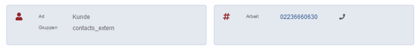

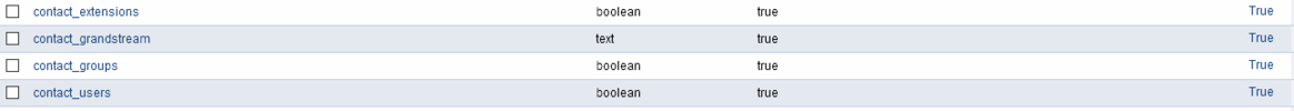

In the defaut settings:
and
under groups:
the user:
the contact:
correct so far?
