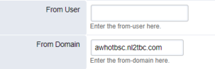

In my gateway configuration settings, i have configured a domain in the "From Domain" field as shown below.
However, when I made call using the gateway, the INVITE message does not show the domain in the From and To Header. instead it is showing
the IP address of my FusionPBX server.
Can anyone advise what other configuration should be done to enable the domain to be shown in the INVITE message for outgoing call ?
Thanks.

I don't really fancy going through mod_sofia's internals, but I think if you use the from-domain, you have to use the from-user too. There's also the 'realm' field which may help, set that the same as the from domain.

Thanks all. the domain appeared after i input in the domain in the Realm field and restart the gateway.
