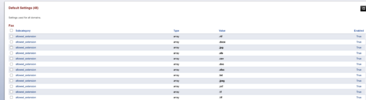

How can I add PDF ?
Make sure you have these settings enabled. Flush cache for a good measure too
Great. That helped. Thank you.
