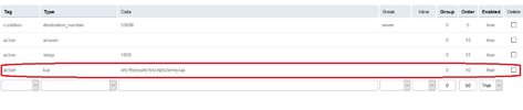

dialplan > dialplan manager > add (top of screen) > name it and add 1 condition and 1 action > save. open up the dialplan that you just created and you'll see a screen similar to the screenshot you'll have to edit for your use. if lua isn't an option to select then you need to install the lua-freeswitch package or something along those lines and enable to module ( advanced > modules > under 'languages' for me

Here's an update. Thanks again for the help. I want to be able to transfer an outside call to "Lenny" which is going to be extension 789. So I've created an extension 789. In "Dial Plan Manager" I've created a plan with the name of "Lenny" and a number of "789". When I call extension 789 I'm getting VM and not the script. Where am I going wrong? I've included pictures of the various pages I've worked on. Thanks.

Like I said I'm unable to get the script to work also, it's the first function block that fails for me. I don't know lua so I haven't been able to figure it out. I assume its not finding the files but I don't know what needs to be done to get it to work. everything you've done looks correct though.

Yes, I had a play and got it working on my test box. I had to modify the LUA downloaded from the link in this thread, mainly to fix some minor issues, but also to correctly specify the sound file location.
I downloaded the sound files, they were all in one directory and called lenny1, lenny2, lenny3 etc... They were in ULAW, so I converted them to WAV and renamed them to match what the LUA script was looking for.
If you look at the LUA script you will realise that it runs two loops, one for responses and one for no responses. You will also notice that the sound files are divided into three sub directories: greeting, mainloop, and noinputloop. I had to work out which sound files belong in each directory.
I made a directory called /usr/share/freeswitch/en/au/lenny/ and loaded the sound files into there. If I ever put this into production, I would record my own sound files to avoid any licensing issues.
My modified LUA is shown below and located at /usr/share/freeswitch/scripts/ A screenshot of the dialplan below that. Have fun...
It's Lenny in Lua

Thanks for the help. I'm struggling a bit and hoping you can help out.
1.) Firstly, I don't see the three directories (in the script) your referring to: greeting, mainloop, and noinputloop. Can you highlight these in the scrip.
2.) What directories did you put lenny1, lenny2 etc. into? Are you able to provide a list of which greetings go in which directory? For example, lenny1 goes into the mainloop directory and lenny3 goes into the noinput directory.
3.) What did you use to to convert the ulaw files to wav format? I've tried Audacity, Goldwave and G711.org. None of them recognize the file. Are you able to upload the converted wav files?
Michael
1,417
377
Ok I will try to answer in order.
1.) The directories are the aType parameter variable in the get_filename function. Eg. get_filename( 'greeting', 1 ) , get_filename( 'mainloop', counter_mainloop ) etc.
2.) I renamed lenny1.wav, lenny2.wav etc. to simply 1.wav, 2.wav etc. As for files in directories, your lenny files may be different to the ones I have. but this is what worked for me:
After I converted to .wav and renamed the files I had 1.wav through to 16.wav. I moved 1.wav to the greetings directory and then moved 2-16.wav to the mainloop directory but renamed them 1 to 15. I then copied 1 to 4 from the mainloop directory to the noinputloop directory.
3.) I used Audacity to convert the files. Use file->import->Raw Data. Choose ulaw encoding and a sample rate of 8000Hz. Screenshot below:
I hope that helps.
