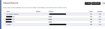

I found this online, but it does not seem to work. What am I missing? The extensions are three digit extensions starting with 2XX.
mrjoli021
Jul 20, 2017
128
46
I have several domains on this box and this particular domain has about 25 extensions. If I set the condition to ${toll_allow} Outbound on my Global Outbound route, then no one can make calls except if I add Outbound to each extension. Is there a way to that I can only change one extension? So all calls are good except if they have a restriction on them

- you need to create 2 outbound routes e.g. internal and 911 (911 should not be in the same outbound route)
- use regex to define the numbers each route can call.
e.g. internal = ^[2][0-9](\d{1
and 911 = (^911$|^933$)
- allow the 2 routes in extensions toll allow.

The Extensions for this domain are 3 digit extensions. I created a local gateway and added a route for the 3 digits under the local GW. In the local route I named the toll Local. I know I would still need to add another route specific for 911.
I then tested my extension and was still able to dial out to the PSTN. From there I went into the extension I am trying to restrict from making PSTN calls and added the toll "Local" to it. After saving the extension, I dialed my 10 and 11 digit PSTN call and it still went through. What am I missing? The Global calls Dont have the ${toll_allow} set just the Local.d3 route does.
