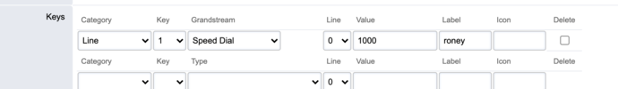

I am facing same issue with the Grandstream 1760 phone.My Vpk Keys are not configuring from auto provisioning .Plz see the attached image.

884
197
A quick look at the gxp17xx template shows there is nothing set for programming buttons. It looks like the template has just enough information to get the phone registered and set provisioning/upgrade servers.
You might have luck using a comparable model template such as the 2135 but it may introduce other unexpected behavior.
Also, Key 1 is usually reserved for the active account.

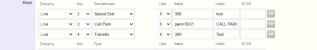

I need the Guide to configure the VPK from fusion for 2170 phones.can u help with that? .So i just succeeded to add one speed dial button .another thing is when i made any chnage in the Provision template in fusion from gui .So after save that do i need to click on provision?

I am setting up like this ? only the speed dial key is configured.Other keys are not working

884
197
Try using "Monitored Call Park" for the park key. Some firmware versions don't work as expected with "Call Park"
I haven't used the "transfer" feature since "BLF" has same effect but also includes presense.
