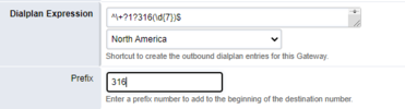

Example:
The above expression will match any 10 or 11 digit calls with or without a "+" to 316xxxxxxx. The 7 digits after the area code are captured for use in the bridge statement. The "prefix" will add the area code to the number in the bridge statement. I'm not sure what number format vitelity expects, but if the + or 1 are needed, those can be added to prefix field also.
Using the details above you would end up with something similar to below. In the screen shot, I have edited the outbound CID to show as 3165551212
