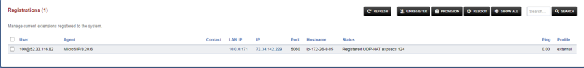

Has anyone used any softphones that work reliably with fusion?
I have tried xlite and microsip and zoiper and it registers the extension, however when attempting to place any call (even to *97 vm) it beeps and says "Not Found".

Also, on fusion, if you go to status>registrations, does the softphone show it's registered? If not calls won't work.
I have attached a few screen shots. I dont now if I blacked out anything that you would need to see. But I just dont know what to do... Like I have said I am very new to this. So any help and advise is greatly appreciated.

I use microsip and it works great, I see your protocol is set to TCP+UDP try changing it to TCP and see if it makes a difference.
bdmonsey
Jul 23, 2019
146
42
Can you tell me what is wrong with it?
not sure exactly, I'm not a dialplan writer pro, but it seems to me that youre trying to put all your dialplans in one dialplan, create a new outbound route dialplan and select only 1 option for example North America and try calling that number again. at the same time have ou tried different codes or just *97? , do you wanna try something like *9664?
