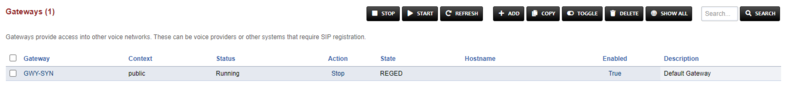

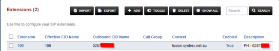

Created an ext on main pbx and assig destion (DID) to that ext then regestered that extention on test pbx as gateway
added main pbx ip to test pbx ACL
Here is the EXT Image on main pbx

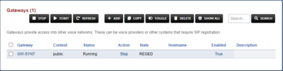

Gere is the GW image on test pbx

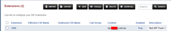

Here is local ext on test pbx

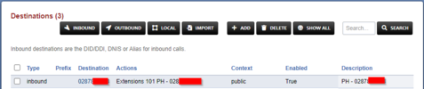

Here is the local destination on test pbx
