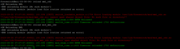

It looks like new installations do not have the xml_cdr module installed.
meshtask
Jul 17, 2019
I have installed FusionPBX on Debian 11 and 12.
I am also having same issue and even tried to fix it with instructions shared in above posts, but no success.
whut
Dec 23, 2022
191
I see in https://github.com/fusionpbx/fusion...ter/debian/resources/switch/package-master.sh that freeswitch-mod-xml-cdr is being installed. modules.conf is missing `<load module="mod_xml_cdr"/>` (and `<load module="mod_tone_stream"/>`).
Still no if I re make mod_xml_cdr and re install and if I add the module to modules.conf and restart freeswitch.
How do we get this module to install and to run? There will be no CDRs until this module is running.
1 week old Debian 11 installation
