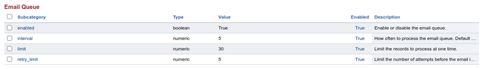

I've upgraded from FusionPBX 4.5 to 5.1.1. I followed the steps in https://docs.fusionpbx.com/en/latest/status/email_queue.html to enable the email queue. However, when running "php /var/www/fusionpbx/app/email_queue/resources/service/email_queue.php" from the CLI, I get the message "Email Queue is disabled in Default Settings". I've checked my default settings and verified against a FusionPBX installation that has email_queue working and they appear the same. When I ran the update I was sure to update the Schema and App Defaults, per the email_queue instructions. Email sending works fine otherwise, so my SMTP settings appear correct.
root@pbx:/var/www/fusionpbx# php /var/www/fusionpbx/app/email_queue/resources/service/email_queue.php
I've tried reloading XML, clearing cache and restarting FreeSWITCH but get the same message.

Try changing the default settings value 'True' to 'true' - all lowercase, save, reload button at the top-right of the default settings page and try your command again.
The same thought crossed my mind, but as a boolean data type, there's just a dropdown for the True or False value. I tried a default settings reload just in case, no effect.
