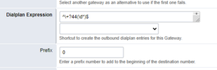

Hello all, I have configured gateway with inbound and outbound routes with Dial Plan: 11 Digit Long Distance calls are working fine when i just input number like 01711XXXXXX , but problem occurs when i dial saved numbers from contacts which is saved included country code +88 as incoming calls always add country code. So when i dial out saved number like +8801711XXXXXX doesn't go through. Is there any solution to dial with my country code.
Here is my dial plan
677
Without the prefix, it's probably useless as your provider will probably expect the 0 prefix.
Thanks a lot it work's. In my scenario i have made tow outbound route with same gateway in with regular dial plan expression 11 digit long distance for without country code and another one is with your expression
^\+?88(\d{11})$
working seamlessly, but prefix doesn't work so i just leaved it blank.
677
Yeh, I don't know if prefix 0 is a British only thing. Every number has a 0 at the start here for national dialling, and 00 for international exit code.
