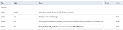

Park dial plan has it's own hold music variable.
There is also a "default hold music" variable set early in the dial plan, then each user can have hold music set differently.
If you don't have a dial plan to set the domain level music on hold before the dial plans created by ring groups, the system default variable will be used.
You should have a dial plan named "domain variables" or similar near the top of "dial plan manager" Add a line to set your custom hold music there.
eg: action set hold_music=local_stream://my.domain.com/mycustomMOH and set "inline" to true.
Here is an example of one of ours:
thanks @ad5ou I will give this a try!
