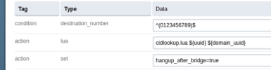

You can call another process such as a script form the dialplan.
Have a look at /usr/share/freeswitch/script/cidlookup.lua
This is an .lua script that can be called on an inbound route to lookup a callers name from the contacts table. I sure this could be adapted to interface with CRM.
