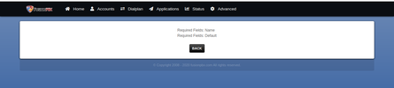

I am new to fusion but have an extensive background using freepbx. The concepts are the same so this should work for you. I was unsure what the extension field is for but maybe the documentation explains it in more detail.
3,044
565
The extension is one you just create like any other dialplan, ivr, ring group etc, just use a number that is not in use.
