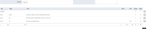

Hi, we need to change the TimeZone only for a specific domain, so we could see it in the 'Call Detail Records'. We have tried setting the time zone in the 'Dial Plan Manager' as you can see in the picture bellow but when we make a call it doesn´t work. I have tried as the user 'JamesBorne' said and it didn´t work anyway.
How should we proceed? Thank you.
